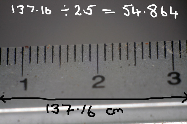

...so, I have a 135mm M42 lens which I use on my Canon 400d. I put macro tubes to it, attach an old flash on a bar, trigger with a cheap radio trigger.
I was interested in the magnification...so, I put 10.5cm of macro tube on with the 135mm, and took this photo, handheld. It's a JPEG straight from the camera.
Photoshop says the image is 137.16cm wide. Well, my ruler shows 2.5cm across the frame.
So, quick maths...137.16 / 2.5 = 54.864.
1cm in real life is 54cm printed at 100%?
So, I have 54x magnification? Is that how it works?

137 cm at what resolution? 72 ppi? 300ppi? What resolution you want to print? Hell.. you can make it 100X magnification but your photo will be pixelated probably.

I opened the document in PS, the document size was 137cm wide. That doesn't change with the DPI in Photoshop. So if I print that, full size, I get a print 137cm wide, do I? a 2.5cm ruler without resizing anything is now 137cm wide?
dont look at the document width.. look at the pixels. what is your pixel size?
Here is the rough math:
Length of one side of your camera sensor in real life
Divided by
Length of a ruler captured in a frame along the same side
For example 1.6 crop camera sensor would have a length of 22.2mm
And you've captured 25mm of ruler length along the long side.
Which gives you: 22.2/25 = 0.888:1 magnification
With regular macro lenses at 1:1 it shows that you're just under what a regular macro lens would get (which makes sense as the very rough math for extension tubes is focal length of the lens/length of the tube in mm = x:1

Bendthelight, just what overread was saying, if you had a 1:1 macro lens, you could put a subject that is a size of your sensor and you will be able to fill up your whole sensor with that subject.
Cheers, guys. I have it now...I think. ;)
What I have is 1:1 (nearly) with equipment costing me a total of £10 (possible less). This is acceptable. :)
