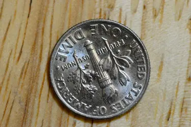

Well I found the metal lever on the back or once it is mounted on the reversing ring that will all the viewfinder to get enough light to focus and then I release it before I hit the shutter.
Here are couple of test shots with a lower light indoors with the sb700 flash.
While that works, it's 1.)totally inconvenient and 2.) only for the minimum aperture.
If, for instance, the IQ is best at f/8, you really don't have a way to set it to that.
