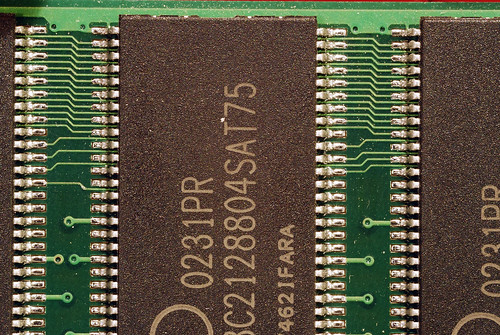

The full picture:
A flickr reduced size picture from a crop of a 100% view of the above pic:
