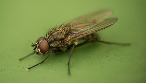

Fly by Pisto1981, on Flickr
Took this today and the fly was a few mm long.
Any idea how to improve DOF? Really not much room for error with these

Shoot at Minimum of F16... even F22 if you light it well! I usually used a diffused flash (sometimes on camera, sometimes off) to get good exposure and contrast. That will also allow you to shoot at smaller apertures more reliably.
Not bad.. It does take a little practice!

You shot it at F7.1. Like cgipson1 said, a higher F# will give more DOF. Nice shot by the way...
