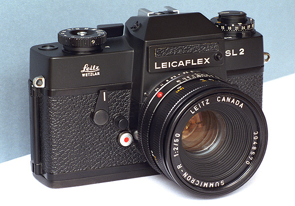

Many of the lower-priced auto-focus SLRs don't have good focussing screens. I use a Leicaflex SL2. It has the best focussing screen ever made. Brilliant, large, easy to see.

What Petraio says is true--I would amend his statement to say that most of the lower-priced autofocus SLRs have poor focusing screens; most lower-cost models use a pentamirror system,not a pentaprism, and the quality of even the mid-level d-slrs is nowhere near as good as the bright and crisp image of say the Nikon D1 or D2 series, which were probably the best APS-C bodies ever made, viewfinder-wise that is. The Nikon D2x has a super viewfinder quality for an APS-C d-slr. STILL, manually focusing an AF camera is not always easy.
Why? 30 to 40 percent of the light goes right through the mirror, and is angled downward, to the AF sensors located in the bottom of the mirror chamber area, behind the mirror. AF slr's use partially transmissive mirrors, whereas older manual focus SLR's used full-reflectance mirrors, and the user focused on a coarser-ground focusing screen, and lenses from the manual focus era had slower, more-deliberate focusing ring travel. Almost any decent manual focus 35mm slr is easier and more accurate and more-reliable to focus by hand and eye than almost ANY modern d-slr is.
The focusing screen inside a d-slr has a bright, smooth ground surface, which is NOT very good for determining focus with using the human eye--a coarser-ground screen is actually easier for the human eye to see and evaluate. If you have to focus by hand, always focus from Infinity and turn the lens toward the closer distances; this works best (long,involved answer,due to lens focusing rate of travel/human eye adaptation). Focus from FAR to near, and as soon as it looks good, stop! You might have to make one small reversal of direction, but this is the best way to manually focus.
Practice and review can help. AF works the best most of the time though, but at times, you'll want to manually focus,so it pays to learn how to get the most out of your gear. Most AF lenses have very short focusing ring travels, and so errors can be quite large. Most manual focusing lenses are easier to focus by hand and eye than most AF lenses. Wide-angle AF lenses can be a total biatch to focus by hand and eye.

1975 vintage camera. Uses phylm. No autophocus. No auto expozur. Manual advanz.
Takes photos like this:
Taken with 180mm Elmarit-R- (Mark 2) lens and Leicaflex SL-2 last Saturday on Fuji NPH (ISO 400) and scanned. I looked at the image under high magnification and discovered the focus went right through her left (closer) eye. I don't think auto-focus can do that.
