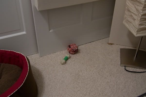

So, the below shot was shot at 50mm.
If I happened to have a telephoto and zoomed in to 300mm, the area in the white rectangle is what I'd see, correct? (I think I did my math right) The handy thing is, I just took the pixel width and multiplied by 50 then divided by 300.. and it works! Now I can go around shooting w/ my 17-50mm and then go home and figure out what the shot would've looked like at 300mm or 250mm, that will help me make my decision on which lens to get.
Just a quick note bear in mind that if this was shot on a 70mm it is unlikely the 300mm will allow you to get this close to the cat. The near focus distance of the lens would likely limit you. So this rule isn't universally true.
Right, makes sense.

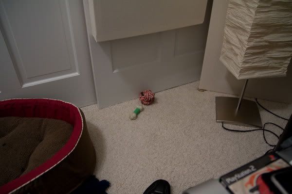

EDIT: for those with a killer eye.. does this look right? Examine the below photos as if they were full size shots out of the camera. The first one is real, not simulated.
17mm (actual true shot):
50mm (simulated)
250mm (simulated)
300mm (simulated)
Pretty interesting.. the difference between 17mm and 50mm (33mm) looks huge.. but the 50mm difference between 250mm and 300mm looks pretty small in comparison. So either my formula is way off, or that's how lenses work :)

OK, turns out it was a coincidence after all. :( Damn!
Anyway, here are image comparisons using your formula, pxw * f1 / f2.
Base 17mm image (actual):
The following will look almost the same, you'll probably have to save to disk & flip back & forth to see the differences.
24mm actual:
24mm simulated:
50mm actual:
50mm simulated:
So you can see, it's not quite exact. I wonder if it becomes more inaccurate with longer focal lengths? Probably, because we're taking a 17mm shot (and the distortion that comes with it) which would never properly translate to a 300mm shot.. still though, I can't help but wonder if there's some formula for it.
BTW, I'm grabbing the focal lengths from the EXIF data.. pretty sure those are exact.
As I said, the formula will not be exact at close distances. It would have to be made more complex, because it isn't the focal length of the lens that really matters, it is the distance from the rear nodal point to the image plane, and that increases as you focus more closely. I could write the complex version if you wish, but I'm not sure that this exercise warrants that degree of accuracy. The simple formula I gave is correct for distant subjects, and the theory behind it is sound.
Also, remember that as you zoom, the point at which the lens 'sees from' changes, so that even if you hold the camera stationary, the lens' viewpoint will be moving as you zoom.
Does the EXIF always show the true focal length of an IF lens?
Try repeating the test with a distant subject.
