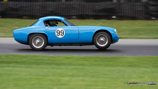

This one, also at Indy, was at 1/125:
If you're just looking at wheel motion, some show it more than others, and some show it only on one wheel (I especially like the "RF" in chalk on the front wheel):

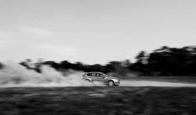

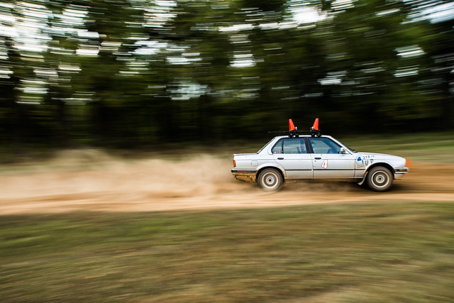

I can probably count the times I've attempted panning on my hand, here are a couple favorites though.
Both shot freehand with a 300mm (2.8) at 1/200.
Only advice I really have is to follow through with the panning motion, basically keep panning for about .5-1 sec after hitting the shutter.
Nice - #2 looks great -- like he's crashing right through the underbrush!
Thanks Lambert! Yeah it does look like that, but in reality the track is 10-15 feet wide. :mrgreen:
