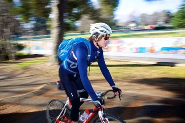

Here's a similar look that I got with a cyclist. I used a small speedlite on the camera to help sharpen the subject. Because he was very close, the flash was able to hit him without affecting the blurry background. This might not work on a carousel where everything is very close together.

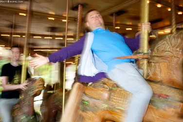

Alternately, you could use a very strong flash on 2nd-curtain to freeze the action with a trail. Here's a photo I got a few weeks ago using that technique. (I'm not thrilled with this look, I think I'd have preferred the panning technique.)
