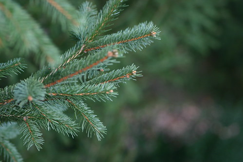

#1
Conifers time by owura02, on Flickr

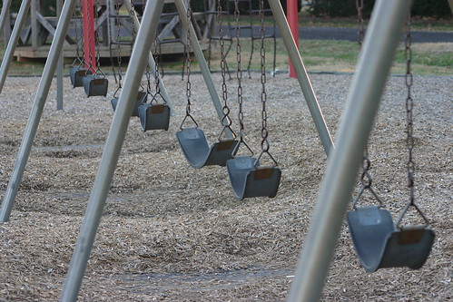

#2
swings in the park by owura02, on Flickr

the first one shows some blur in the background, and not all the swings are sharp; however the flash fired on the 3rd so all bets are off.
So explain the three images ...
Explain the images? How? All i was trying to do was to isolate subjects, which i think I did in #1 and #3 after several shots. In #2, as mentioned earlier, my goal was to isolate the third swing but I wasn't able to achieve that. As far as having themes for the pics, I didn't have any. I just went to the park just to practice. As I said earlier, that was my first time using a SLR.

Thank you all for responding. All of you mention that the background needs to be further away in order to be blurred. So, for instance, in #2, if I want to isolate the the third swing, how do I blur-out the first two swings and the others? Do I just move closer to the third? If I do that, I assume I will be cutting the first two from view.
Your swing set is a good exercise subject. You may be wishing for something that you can't have. The control that f/stop exercises over DOF is limited. DOF is a function of f/stop + magnification. Magnification is the dominant determinant of DOF. At a given magnification (lens focal length + distance focused + sensor size = magnification) you will have a working range of DOF possible from the range of available f/stops. That working range may be more or less than you'd like -- increasing the f/stop range may not help. Take the swings: Let's assume you used the 70mm end of your lens and have a camera with an APS sized sensor. Now let's assume you were 20 feet from the 3rd swing and took the shot at f/4.0. You've got 3.6 feet of total DOF -- more than you'd like. If you switch to a faster lens and try again at f/2.0 you'll lose 1/3 that DOF. The only way to lose more DOF without altering the composition of the photo then would be to increase the size of the sensor -- and that means a new camera.
