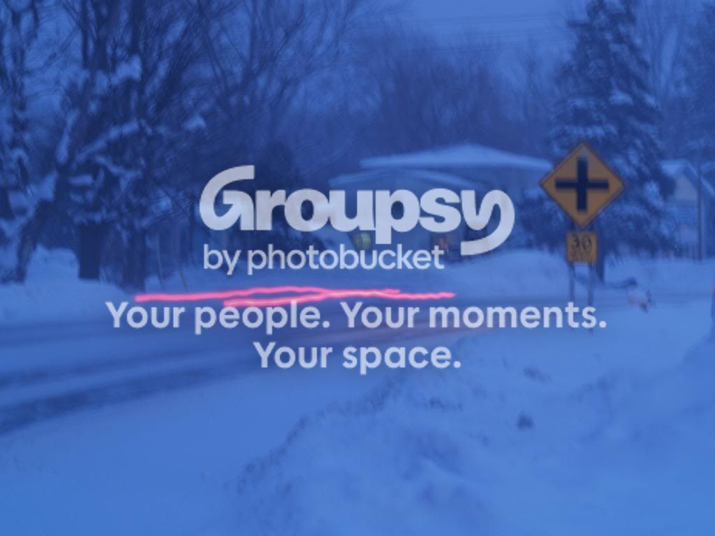

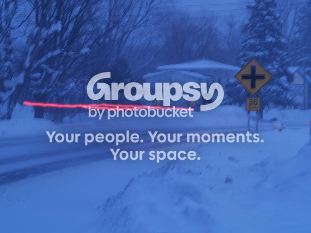

what exactly causes that?I was playing around w/long exposure one night a few years back,trying to get streaky tailliights of passing cars.....in some images (the longest ones) the streaked taillights were there but no car.
The taillights are a lot brighter than the cars. The cars were so dark, they didn't register an image on the film/sensor.
here are 2 of those shots..both 2 second exposure...

if you look close, the cars ARE there. But they're 'smeared' across the image just as much as the taillights. If you look, you'll see the image is darker where the car passed through.
