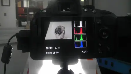

I think the F14 looks good but i cant seem to understand why the black dial has like noise or grainy when u zoom a little in. Is it my camera or my technique. I shoot with the nikon D5100.

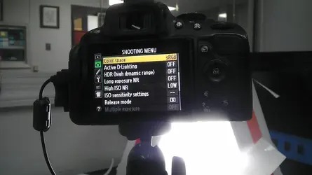

I also took a picture of the setup i use in my camera setting, Do you see anything thats wrong with my setting?
Set your camera to view the histogram when reviewing photos. When you look at the histogram the far right side represents full overexposure (white with no details) and the far left full under exposure (pure black with no details). The reason for the noise you can see is because the photo itself is underexposed by (I'd guess) around one stop. You can see this yourself on the histogram as you review, the vertical lines on the chart represent one stop of light (be that in aperture, ISO or shutter speed) and if you've a whole bar (or more) spare on the left side it means you've got more exposure you can potentially use.
If you're shooting full manual just let one setting overexpose the photo on the meter reading by one stop; if using semi-auto modes read in the manual for exposure compensation and set to one stop more).
Further have a read of this site here in the noise and sharpening sections; the noise you have is so tiny that not only would its removal be easy but at a print or webresize you would never ever see it anyway.
