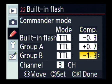

D80 has commander mode. Put it in manual and go to strobists.com and check out the lighting 101. Have fun!

What does "commander mode" mean?

You can control you flash off camera with it.
