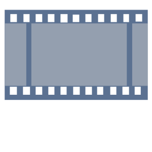

Thanks. Honestly I do not know much about film photography so I need to dig into these photos and see what they are. How can you tell when looking at them?
35mm above
medium format (120mm)

Changed pic to link to a different negative where you can really see it. If you never really got into film photography, im guessing it will be 35 mm.
Thanks. These do not have the holes at the top and bottom like the image you posted. I guess I can go by the camera shop near my home an ask them what it is. It looks more like the flickr image you posted, but not a long of a strip.
The Flicker image is not accurate enough to differentiate between some of the roll film sizes. Here is a short list of common sizes:
35mm: 35mm wide, sprockets on both sides, 24x36mm image (8 sprockets / image) for full frame and 18x24mm image (4 sprockets / image) for half frame
