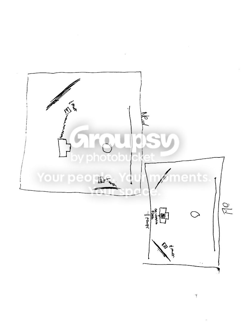

Ok so I did another shoot yesterday and did what you guys said and dropped the power on one of my flashes and I found that it created a "two faced" effect in that one side of the face was slightly shadowed, but it was split right down the middle.Is this a desirable effect? From what I've seen in portraiture, this is not a good thing.
this is a diagram of my old lighting set up and my new one. Any suggestions for how to improve this?
That is called split lighting and it probably isn't very flattering for your subject. My advise is to look up lighting diagrams for beauty lighting or Rembrandt lighting. Those styles tend to model the face in a nice way.
