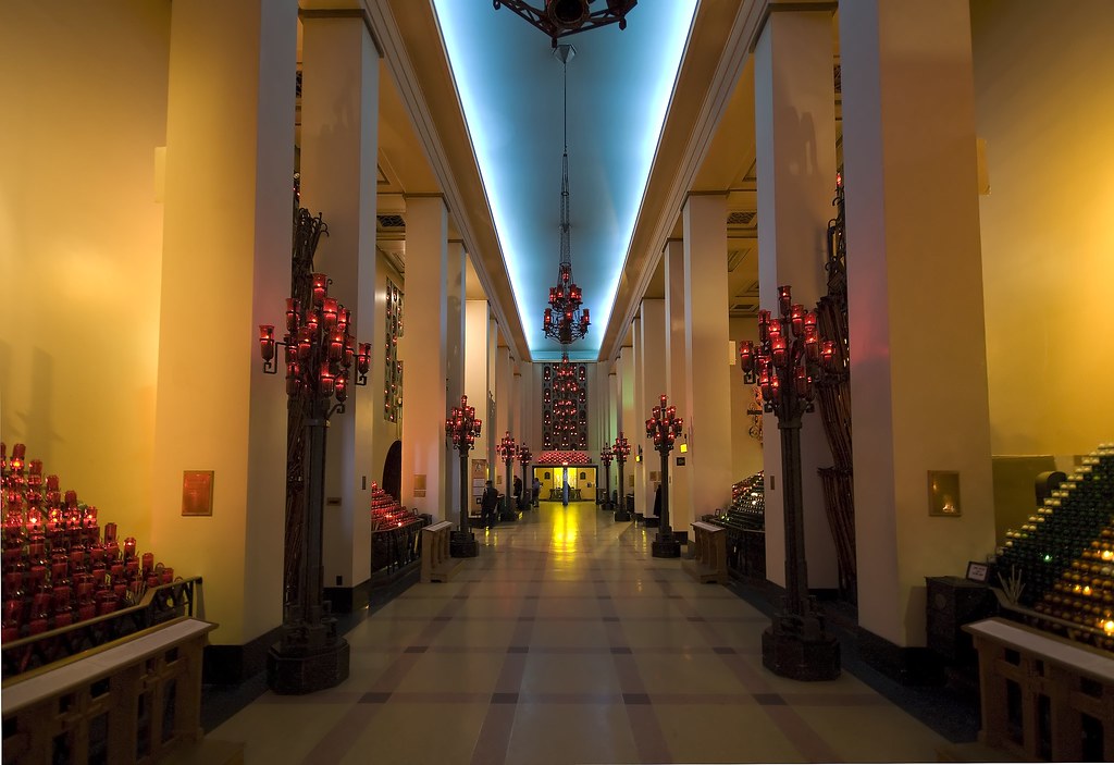

Here is an example of a picture taken with a 0.8 second shutter speed, ISO 400 and F/4.0 aperture. It is about double the length of time of your first two pics. It was done hand-held, but I had to use every trick in the book to get it (breath control, ISO, speed, custom WB, back leaned against my backpack that leaned against a wall, proper camera holding technique and a couple other things were used to get this shot... but it WAS hand held). This was also in a VERY dark place, where candles were *almost* the main light source:

Here is an example of a picture taken with a 0.8 second shutter speed, ISO 400 and F/4.0 aperture. It is about double the length of time of your first two pics. It was done hand-held, but I had to use every trick in the book to get it (breath control, ISO, speed, custom WB, back leaned against my backpack that leaned against a wall, proper camera holding technique and a couple other things were used to get this shot... but it WAS hand held). This was also in a VERY dark place, where candles were *almost* the main light source...
Very good shot! Obviously, it's a church but the area is long and narrow. Where is it?
Thank-you for the compliment. :) This is a place that I could spend days shooting at, and one of my favorite places to go for a little "personal" time when I am needing a little one on one with the "big man" above. ;) Its St Joseph's Oratory in Montreal, Quebec, Canada. Its a huge place and a photographer's dream to shoot.
That shot I first posted is just past the main entrance.
