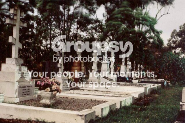

ok so my scanner finally works again, excuse the poor quality. But here's what i came up with when I was out photographing. I was trying for a creepy night pic. The only thing that's really creepy was the trees and the colour tones. But still it wasn't what I was after.
