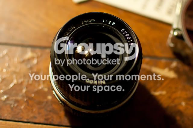

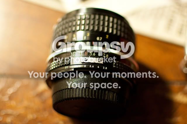

I have the following Nikkor 24mm 2.8 lens, I looked it up on the Nikon lens serial number site and it appears to be an Ai lens. When I put it on my D90 body (which I just got today), it will not autofocus on the body. Any reason why?

Pics of my lens:
Because it is a MANUAL focusing Nikkor.
..................and there's no electrical contacts on the mount that the camera would use to focus it with?
The D90 has a mechanical screw-drive focus mechanism that is used for AF lenses that do not have a focus motor in them, unlike Canon cameras that have had no mechanical connections between the camera and lens since 1987.
Nikon DSLR cameras still actuate the lens aperture with a mechanical body to lens connection too, which is why Nikon lenses all stop down to their smallest aperture when they are removed from the camera body and open to their max aperture when mounted.
