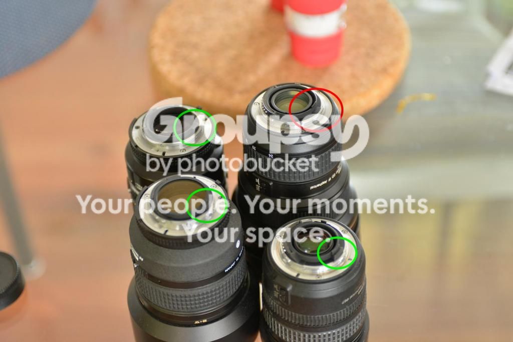

Can anyone explain why there's a mechanical stop missing from the Nikkor AF-S 14-24mm G ED? A picture showing the lens against a Nikkor AF-S 18-200mm f/3.5-5.6 IF-ED G, MicroNikkor 105mm AF f/2.8D, and a Nikkor AF 85mm f/1.4D is shown below.
The 14-24mm is missing a small mechanical stop. This allows you to turn the lens past the white dot on the camera when unscrewing and continue rotating causing another part of the F-mount to cut in right above the electrical contacts for the lens. The lens works just fine but I can see long term if I'm not careful the electrical contacts will likely fail.
Anyone know the reason for this or can give examples of other lenses missing these stops?

Right underneath that tab I blamed is an M0.8 screw which sits proud into the mount and hits one of the three overhanging pieces in the F-mount. The screw is missing from my lens.

My google-fu did well today. The notch is the lens speed indexing post. It tells AI cameras what the maximum lens speed is. Thus the notch isn't actually needed on G series Nikkors as they can't couple to AI cameras anyway. There's no aperture control.

Those have a tendency to fall out. We've replaced dozens in the rental house.
Not surprised. The thread engagement is horrible, about 4 threads deep. I pinched the screw from another lens I haven't used in months.
