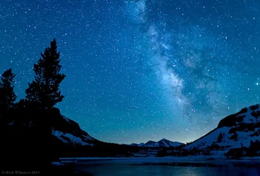

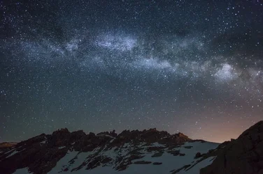

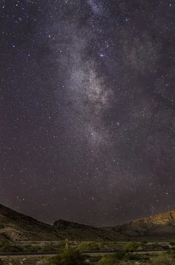

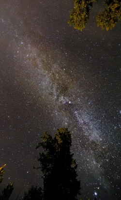

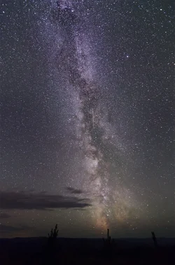

I am really edging mostly towards the Nikon D7100, the only thing holding me back is the amount of night sky pictures taken with it I seem to be finding, and the few I do find are of (to me) questionable quality :/ An example of a Nikon D7100 picture I did found but do not really like is
Something about it just turns me off, I think it seems like the stars got fuzzy edges which may be what annoys me.
On the other hand, I found pictures like
In my opinion the last batch of pictures is simply of superior quality, they just look more pleasing.
I know some of them are made with way more high end cameras, but even the picture made with the D5100 looks more pleasing than the D7100 example I found.
So my question is, how close can the D7100 get to the second batch of pictures, those I actually like, when using a lens of a good enough quality? Is that example of the D7100 in this situation I found just a bad example? And does anyone have some star / milkyway pictures made with the D7100 that may ease my mind a bit?

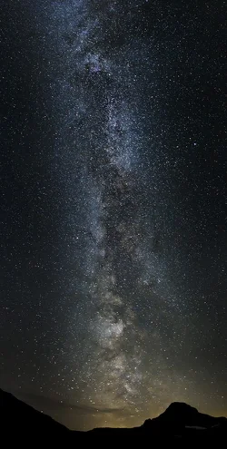

Here are a couple of shots I took practicing to shoot the milky way with my D7000. In both cases the lens is my Tokina 11-16m f/2.8. I took the first one in the front yard. There is a lot of light pollution from town but the bottom right shows the darker part of the sky.
