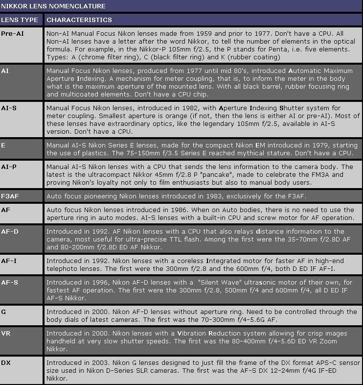

so i found these on some nikon site... BUT i don't understand it at all... lol. could anyone explain?
