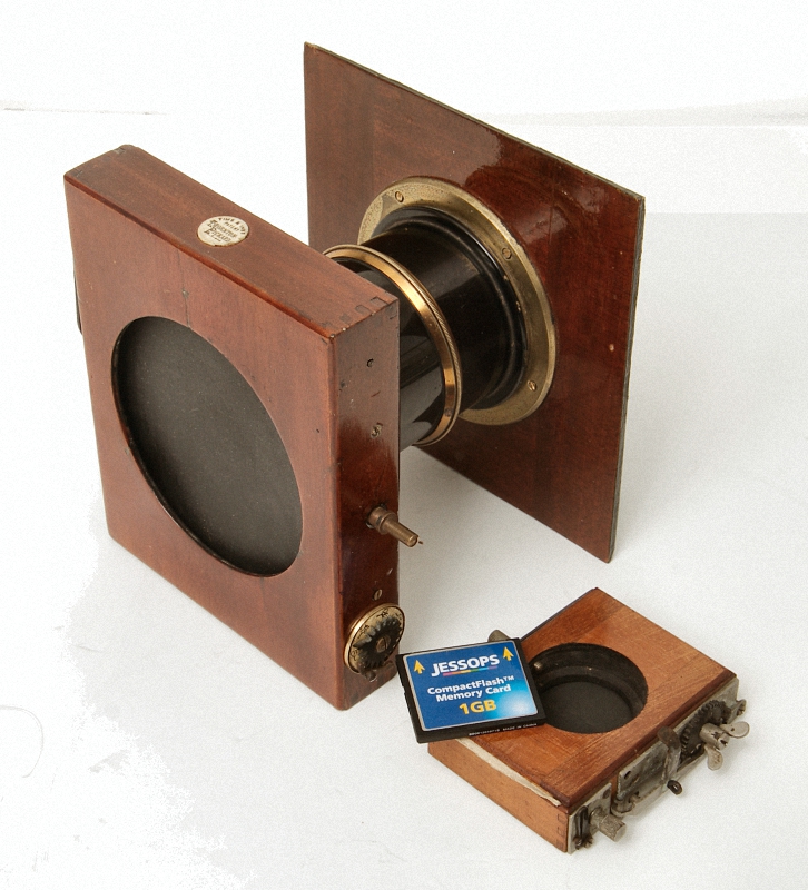

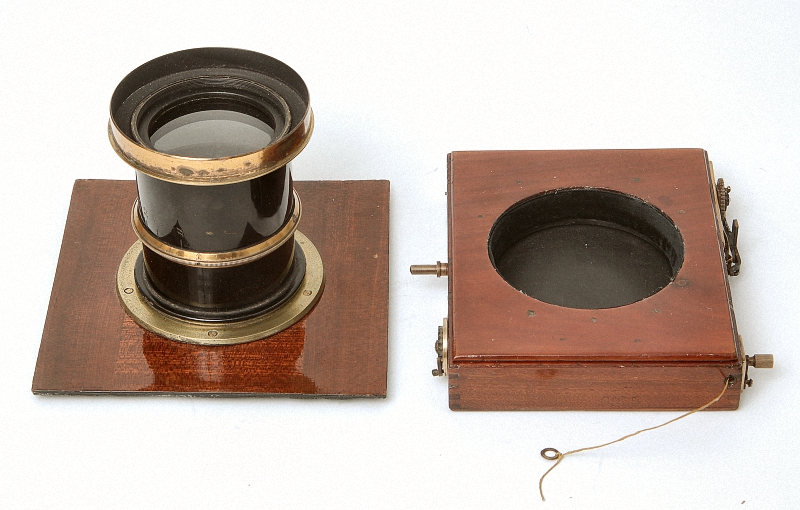

Went to a Camera Fair in December and found a large Thornton Pickard shutter, haggled on the price and was very surprised to find on getting home that it was a perfect fit for my 20" Rapid Rectilinear lens.

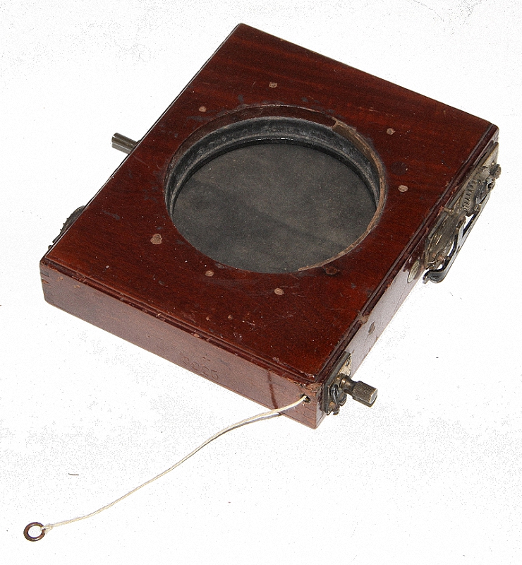

The shutter had cracks and the curtain brittle & cracked with pinholes.
After restoration
With the 20" Rectilinear lens
Just for scale

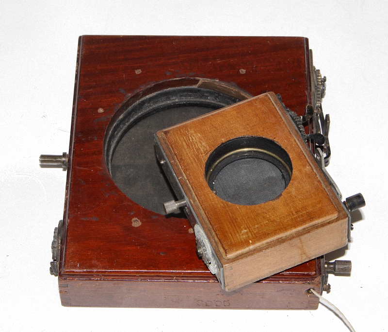

Actually I have quite a few of these shutters, all restored this is the largest though.

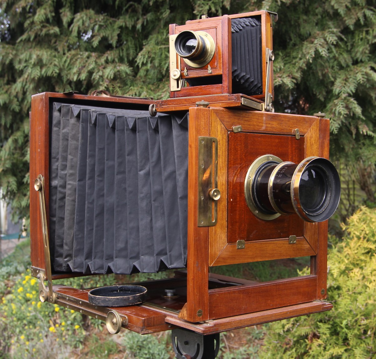

The lens fits this camera:
I've also made an adapter to fit the lens and lens board on my 10x8 Agfa Ansco Commercial View.

Usually I replace the curtain but in this case I remove the old hardened and cracked light-proofing material with solvents and once clean re-light-proofed it. It depends on the state of the original curtain, it's quicker usually to just replace.
There's no suitable replacement material on the market, normal shutter cloth isn't dimensionally stable enough for large shutter - it stretches. I make my own which I also supply to a US restorer as well, he uses it for large Portrait Graphics, their shutter curtain is about 5 foot long.
