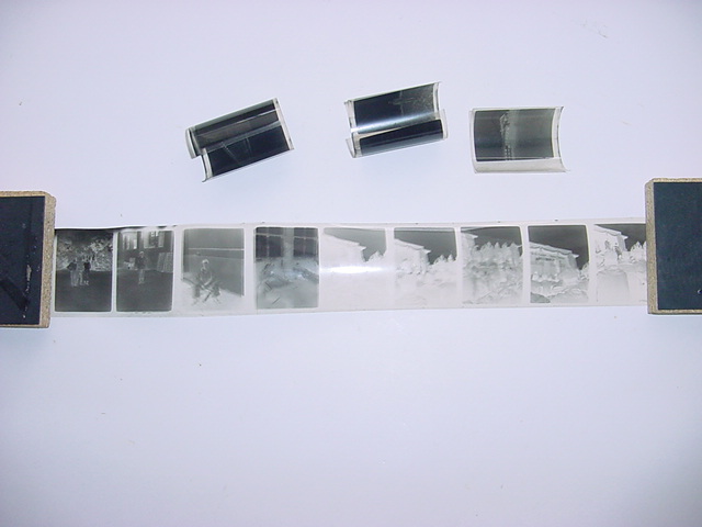

Gentleman,
I am new to this forum and basically looking for some help, idea's, and/or suggestions. I recently purchased a WW2 Veterans estate that contained some photos and negatives. The negatives that were flat were already printed into photos. But there are a bunch that are curled and rolled up. I have a feeling that there are some that could be historically significant. I am looking for someone that could print these (or at least the ones that are salvageable) into photos for me. I thought I would ask here, as this does not seem like a job for my local 1 hour photo store. If there is someone here that could do it, or recommend someone, I would really appreciate it. I live in the Twin Cities of Minnesota. Thanks!!

Thanks for your response. It does help. These negatives are all black and white. And not all are cut individually, most are on a roll. They do unroll fairly easily, and do not crack or split when I do this. The height of these is about 1 3/4" and each image is about 1 1/4" wide. I was hoping to find someone to work with these here. I am certainly willing to pay, but don't want to spend an arm and a leg. I believe these are historical photos and would like to preserve them, so any further information you could offer or help is much appreciated. Thanks!

Are they curled towards, or away from the emulsion?
If they were curled towards the emulsion, I'd wetting one with a mist of distilled water, and hanging it, as per modern films.
Also, I'd ask myself, what would I need these uncurled for?
If I was printing from the negative, I think I might just (ever so carefully) sandwich them between two peices of anti-newton glass.
I also might look at copying the negatives, onto new negative/positives made from modern, ultra slow film.
