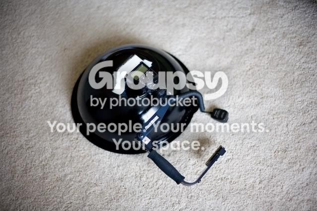

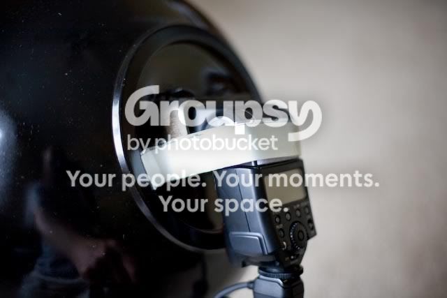

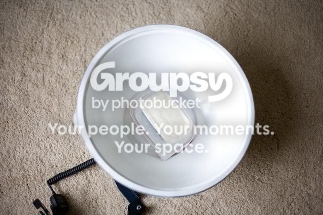

However, there are times when you may want a direct, very soft light. I've purchased a couple of "professional" light modifiers and used them with sucess, however, none of them are really any better that what you can make yourself. Here's a couple of shots of a homemade "beauty dish" I made for about $10.
Bare flash on camera
With beauty dish
with beauty dish
As you can see, the dish softens and diffuses the light, almost like window light.

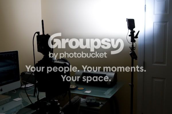

However, eventually you're going to want to get your lights off camera. The most practical way for you to do this is to invest in a couple of cheaper speedlights ( I use 2-Sunpak 383 lights) and some remote triggers. I favor pocket wizards for a number of reasons but there are cheaper alternatives.
Having the ability to place your lights where you want them and fire them remotely will elevate the quality of your shots from the "good" to "great".
I also own some studio lights that I will use on location from time to time but I rarely take them outside. When I do thought, the results can be incredible.
A shot of the lights used in the above shot.
