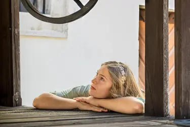

These are another photos from the same session, is it still too busy in the background?

#6 shows how pose and composition can connect. I would try to burn the hot spot along the top of the arch in the background. Try cropping out the top section of the wall in the left corner?
My fave of the series. Great mood.
Again even with an environmental portrait you want a defined focal point and everything else should compliment but not compete or distract. Of the three, the 2nd one does that best. In the other two its less obvious what your focal point is.
