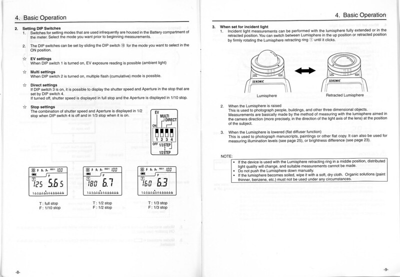

Digital hand held light meters usually have a default light reading setting of 1/10 stop steps, which illustrates how accurately many pro photographers control exposure.
Which meters?
I use a Sekonic L-358 (which I am led to believe is more-or-less industry standard), and 1/3 stop is the highest "resolution" it can do. You can set it for 1/2 or 1/3 increments, but nothing beyond that.
I'm not sure what good 1/10 increments would do anyway, since it wouldn't be a usable setting on any camera.
As far as overexposing to get good skin tones, I just use the exposure my meter gives me - I haven't noticed it being wrong yet.
Which meters?
Perhaps you should RTFM! Page 8 to be exact. Depending on how you set the dip switches you can have either 1/2 stop, 1/3 stop or 1/10 stop. That's how my L-358 works. ;)
OK, but still... It would give me settings that I wouldn't be able to use.
And that would make it FULL stops for shutter speed, and 1/10 in aperture only - which would be even less useful. If anything, shutter speed in 1/10 stops would be the most useful - at least that might give you a setting that is possible to set your camera to.
Hmm... Still. It would give me settings that I wouldn't be able to use.
Opps....................:lmao::lmao::lmao::lmao::lmao::lmao:
Do you ever work with adjustable studio lights?
Well, it all makes sense now. No need to make fun of me though, lol.
I don't use studio lights, but I do know that they are adjustable in 1/10 power increments - I just forgot, I guess.
edit
Still - Why does T revert to full stops when you enable 1/10 stops for aperture? *That* doesn't make much sense to me... (I get it, with studio lights - but why could they not ALSO let us meter with T in 1/10 stops, and aperture in full stops? Could be useful for, say, exposures between 2 and 30 seconds.)
