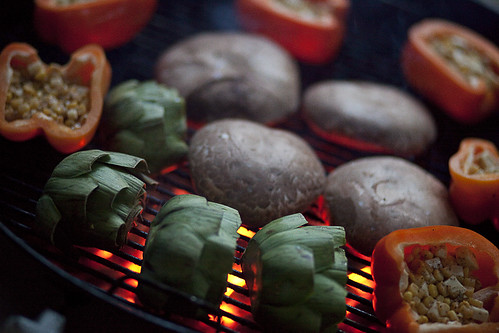

Here is a photo with WB adjusted for the lighting at the BBQ (warm incandescent lights at that spot):
And here is one with a Hoya R72 on:
As expected, the embers emmit strong infrared radiation - and the sensor is only too happy to record it. It is an additional light source in the frame, visible only to the camera, and the effect gets stronger as ambient light gets lower. WB value doesn't really matter, because IR "color" temperature is by definition different to visible light.
