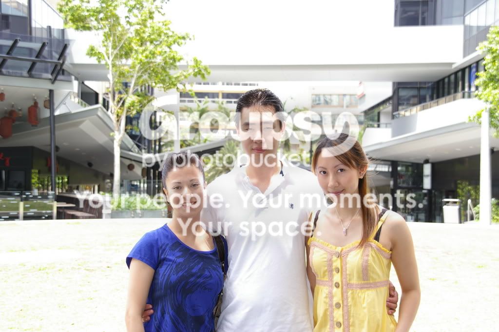

hi guys, i have a question
how do you take portraits of people in bright lighting situations
it was really sunny out and the camera doesn't quite get the metereing right
the subjects are underexposed,
i locked the metering to the surround, and set the flash on, then the whole picture is overexposed
and then i tried it focusing on the subject and the background is underexposed!
argh!
how do i get perfect exposure of the foreground and background?
do i adjust the flash power? my camera doesn't seem to be able to do that, and i think Flash Compensation will just create a generally underexposed photo and not solve my problem
cheers fellas

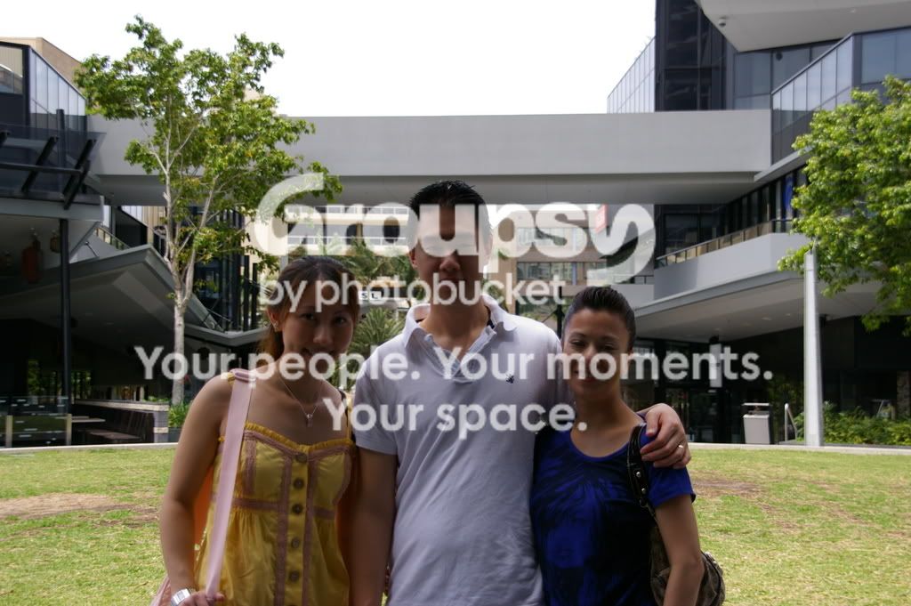

regarding exposure this is the best of the three shots.
If you do not have a flash or reflector, this is all you can do... expose for the main subject. Actually , her face is still underexposed a bit.
If you use a flash, off-camera flash would be a good idea as mentioned.
Oh, and by the way, the first an d the last are totally different lighting situations! in the first scene the background (sky) is much brighter than the people, so if you had exposed for the people, the background would appear even brighter (basically blown out) than it does now.
In the last scene, part of the background is much darker than the main subject. If you had exposed for her face, that background would come out a bit brighter, but you might have lost the sky then, which might be blown out then.

But Alex did hit it right on with the first and last picture analysis, but the solution, IMHO is basically the same. You meter off something behind them (knowing WHAT to meter off is the big trick!)
- In the first pic you meter off that catwalk above the man's head and use fill flash at ~ 1/4 to 1/2 power (or use TTL to adjust strobe automatically), to get a proper exposure of the people.

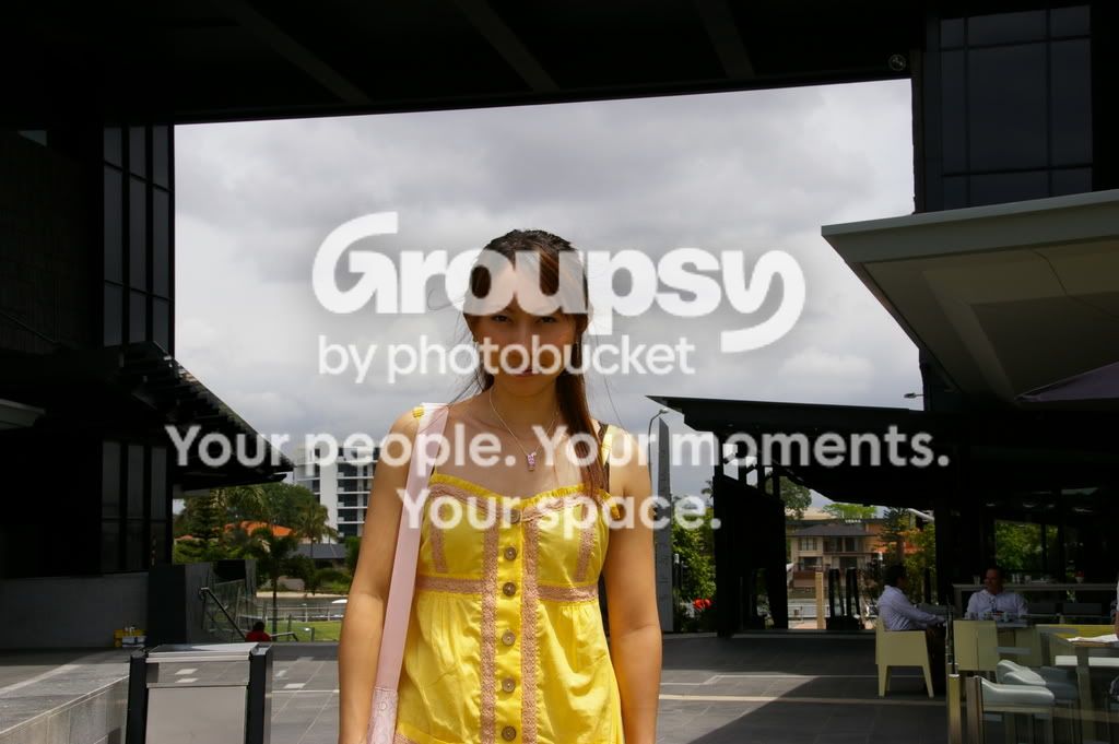

In the last pic you had two choices:
(A) if you had moved over a little to put her in the shade on the right, and metered off of the dark building, the sky would have been blown out but the details of the buildings and the lady would have been correct.
(B) Left everything as is and just metered off her face, the building would have had a LITTLE more detail and the sky blownout some, but the lady's face would have had the correct exposure. This one would be my choice as the sky would be blown out less than using method (A).
(C) The unmentioned (and possibly not possible for non-Nikon users), choice ( :lol: ). Shotting RAW. Meter off the darkest part of the buidling. This then overexposes the woman by about about 1 stop and overexposes the sky by about 3 stops. In Capture NX, install a colour control point on the sky.. reduce it by 3-4 stops. Install a colour control point on the woman.. reduce it by 1 stop. Near percect exposure everywhere without HDR. ;)
Either would work, but you choose how you would have wanted to handle that one, but some form of spot metering would have helped a lot here... along with the off-camera flash, of course.
