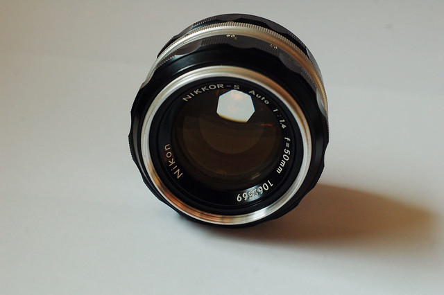

So, I have been trying to purge some of my gear that I no longer use, and as I went around listing my lens various places, I listed a 24mm and 50mm AiS lens here in the Buy and Sell forum. This evening I get an inquiry from a forum member and after a bit this member says that with his research, he believes that my 50mm AiS lens that I have listed is actually a pre-Ai lens due to the markings on the front of the lens. This baffles and confuses me because I have USED this lens on my D50, I know without a doubt that it mounts to my camera with no issues. A little bit of history on this lens, it's one that was passed down to me from my father who was an amateur astronomer in his college days, he was the original owner of the lens so I didn't purchase this lens from another seller thinking it was an AiS lens. In researching the pre-Ai lens, I notice that the markings on MY lens do match most of the markings on all the reference pictures of the pre-Ai lens. (Namely, the Nikkor-S Auto wording), but my lens is absent the "Nippon Kogoku Japan" markings. The mount DOES appear to be identical to the pre-Ai mounts, and everything I have read says that the pre-Ai mounts will damage a modern dslr. Now, confused, I took the lens out of its bag, and MOUNTED IT TO MY D50. Then I took *this* picture:

DSC_0148 by G-Fi, on Flickr
The offender

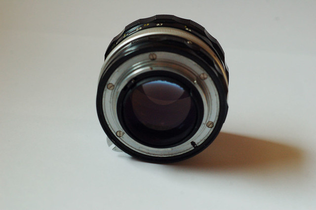

DSC_0149 by G-Fi, on Flickr
I've used the same lens on my D5000 before without any problem, at all. However, I should point out that while my lens looks NEARLY identical to yours, it does have the "Nippon Kogaku Japan" marking.

ANd YES, that lens is definitely, 100 percent, without a doubt, what is now called a "pre-Ai" vintage lens....its a Nikkor-S Auto, which is simply put, pre-Ai.
Your photos do not show the most-critical area, which is the back edge of the aperture adjustment ring; that ring on "many" older, pre-Ai Nikkors, is somewhat large in diameter, and can damage the minimum aperture sensing lever on several d-slr bodies; the minimum aperture sensing pin is located at around 7 o'clock, at the bottom, left of the lens mount area; that is a CRITICAL part of the Nikon metering system. It tells the camera that an attached lens is set to minimum aperture, and also what the minimum aperture "is".
The D50 HAS a minimum aperture sensing pin; the Baby Nikons do NOT HAVE this part!!! THis lens probably really ought not to be used on a D50 (nor on a D200 nor a D300), but it is 100 percent fine, perfectly, 100% fine, on a D5000. (the minimum aperture sensing pin is not to be confused with the Automatic Aperture Indexing follower, located at 2 o'clock on the lensmount periphery.)

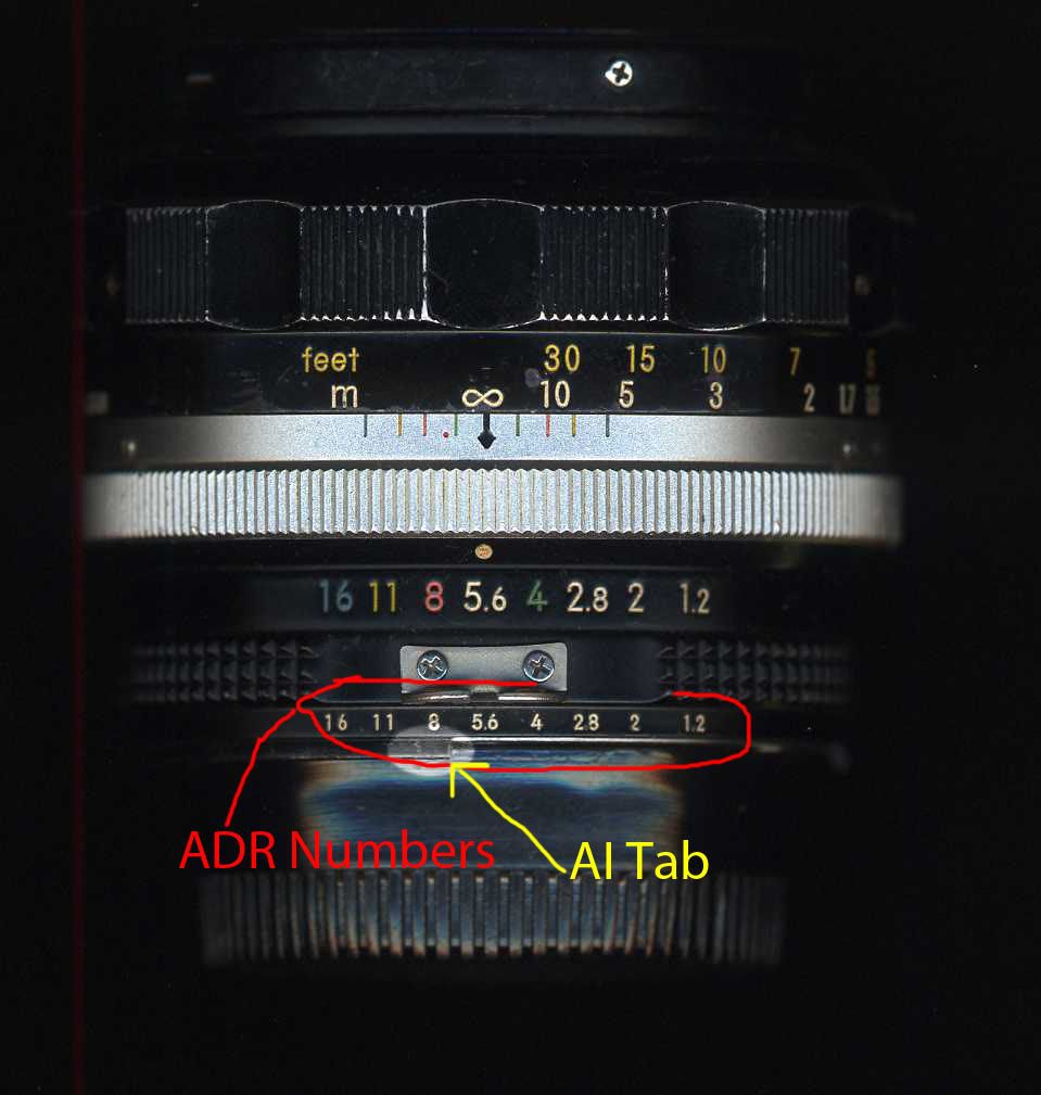

A few things to consider:
Anytime you see a solid coupling fork, assume it's a pre-AI. While some conversions retain the solid fork, it makes it difficult to see the ADR numbers (Aperture Direct Readout) as no light falls on them.
The appearance of the Nikkor Branding and lens element count, e.g. my 55 1.2 Nikkor S-C (see Grays of Westminster Glossary: Early Nikkor Lens Designations), implies that it started out as a PreAI lens, but in my case, the lens was factory converted to AI, indicated by the ADR indicators, the later version coupling fork and the existence of the EE coupling.

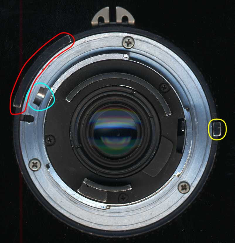

The last series of lenses, AI-S, can be differentiated by two main physical differences, the minimum aperture on both the ADR and larger numbers are orange, and there's a scallop cut into the mount near the locking slot, see the attached image with the area circled (sort of) in cyan. AI-S lenses have a linear stop down action, as opposed to the non linear action of the earlier lenses, allowing the camera to set the aperture in program mode, it is the same approach used to set aperture in AF lenses as well. The area marked in red is the AI coupling ridge.
Regarding modifications, if the aperture ring has been filed, assume it's at least a minimal AI conversion, though it probably will lack the minimum aperture post (also known as the EE servo, see area in attached image circled in yellow), as few modifiers actually add one, see: Precision AI Modification. There are numerous Pre AI lenses that were factory modified (by exchanging the aperture ring for another), these have all the functionality of an AI lens, and are typically priced more than an Pre AI, but a little less than the same native AI lens, though some seem to be far more valuable. A good reference for the inexperienced is Thom Hogans page here: Nikkor Lens Technology and Lars Holst Hansen's page here: DIY Nikon AI modification

I've added this image:
which shows clearly the ADR and AI tabs.

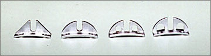

Garbz, there is a progression of coupling forks, 4 different versions have existed. The image below (from the mir.com nikon site) shows them from left to right, oldest style to newest. The two to the right are AI type forks, note the holes in them to allow light to shine on the ADR numbers.
When I said "solid coupling fork" I meant one of the two on the left, as opposed to the ones with holes in them, which are the AI/AIs style.
