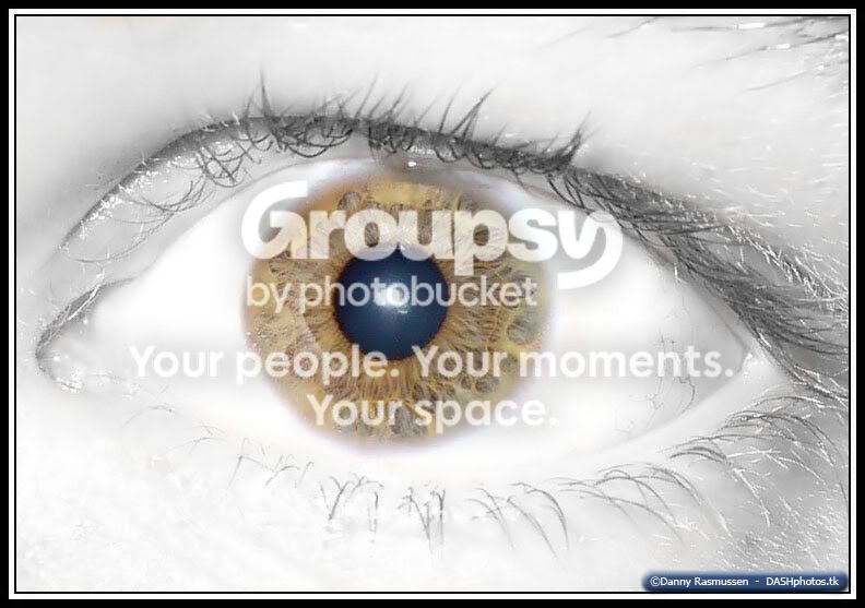

How come i never get a red eye when i take close-up photos of my eyeball? Even when the redeye reduction is turned off, it still turns out perfectly normal:
Wow, what a pretty eyeball you have! My guess would be your eye is so close to the lens that the reflection from the retina is not hitting the film/sensor.
