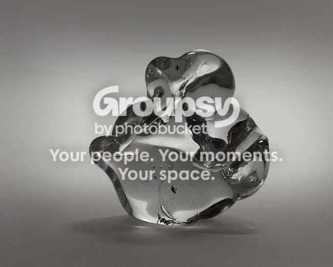

Okay, I suppose another option is to place the object far enough forward of the background and the light will naturally fall off... and/or it wouldn't take much work to airbrush it in...
The top of this image is airbrushed..
Cheers, Don

No graduated backstop is needed... if it is one colour (basically any colour will do, but medium grey will work nicely), all you need to do is control light drop off.
All that you are trying to do is control the depth of field of light. Now, before someone jumps on me, yes, light has a depth of field and yes, it is controllable and no, you do not need 15 lights to do this... more like one, *maybe* two flashes are all that is needed.
For info and ideas, check out my blog entry on how to do this. :) The principal concepts are that, yes light falls off, but you can make light fall off VERY fast. Get the keylight very close and have room in back for light to fade out. If done right, you will not need more than a few feet behind the pots. I've done it on a table top with one flash in my blog example.
