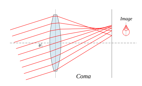

It depends on the design of each lens and what approach each design takes for controlling optical aberrations in the lens. - Camera lens - Wikipedia, the free encyclopedia
Field curvature
