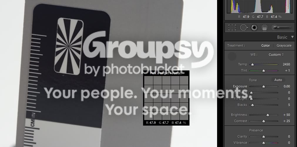

Also, when using the dropper tool, I know you should select a white/gray area, but this give varying results. Is there a way to set the WB with the dropper tool utilizing the RBG percentages near the bottom of the dropper window? Should you aim for them to be as close together as possible, and would that necessarily indicate a correct WB?

Anyone else have a thought on this? Should I be satisfied if the three numbers are nearly identical, regardless of what the numbers actually are?

Even on a grey card or a WhiBal, they're not usually going to be identical (damn close though). If for whatever reason, I didn't take a WhiBal shot and I have to fix the WB later - I use the dropper on something neutral. Neutral does not necessarily mean white (many people assume that you have to use something white to white balance...).
I try to pick a spot where the RGB values are relatively close - within a few points of each other.
A WhiBal is hard to beat though... ;)
What the numbers say shouldn't be a factor in your satisfaction - base that on what the photo looks like. ;)
