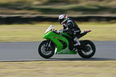

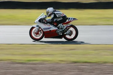

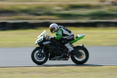

I have attached some examples of the range of results I have got, from my better one to the ugly. I was using backbutton focusing and the centre focus point. However the tips on technique from KmH have shown me already that my 'sloppy' technique has probably a lot to do with it (damn, I was after an excuse for that 7D!:lol:)
Please have a look guys and I appreciate your help.

You want to be on AI-focus mode, rather than AI-servo.
If you were using a 1 series body or a 7D I definitely think it would improve your focusing, but they still don't make up for bad technique.
