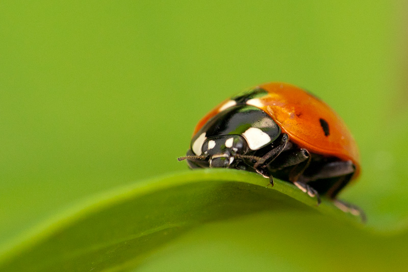

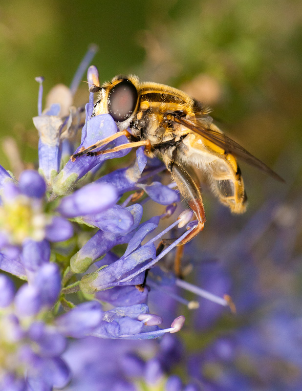

Here are a couple photos of mine, shot with a Canon 400D, Sigma 70-300mm and Raynox 250.

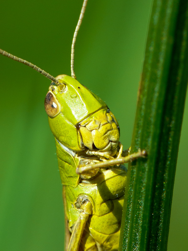

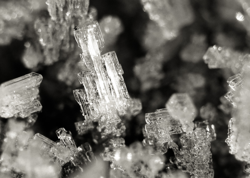

These are even older, shot with a Panasonic FZ7 P&S and the Raynox 250.
Wow .. lovely pics Drake .. I was also looking forward to using the Sigma lens .. or the 50m 1.8 with some filters.. these images have really spurred me up ..
I know it would take time to focus as the depth of field would be very shallow .. But am looking forward to it ..
