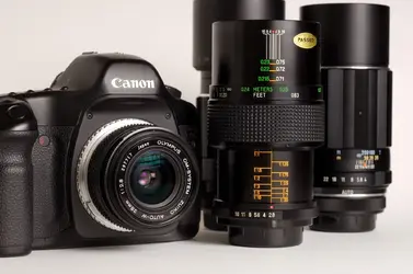

Here's a quick photo I made a while back, showing my Canon 5D body, fitted with an Olympus OM-series 28mm f/2.8 lens, and then to the right, in the back row left, an M42 mount Super-Takumar 135mm f/3.5, then back far right, an M42 mount Super-Takumar 200mm f/4, and in the right front position, an M42 mount Vivitar Series 1 55mm f/2.8 1:1 Macro lens.
