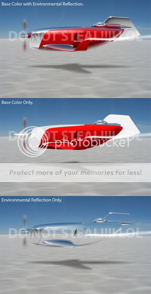

I know many people here have mentioned lighting, time of day etc etc.
For me, it has very little to do with lighting. It has everything to do with the environment that you choose to shoot at.
Matte surface will show how the surface flows with respect to the light source, which means it will show light to dark. This is why if I paint a piece of canvas from light to dark then to light, you will think it is curved. It fools the brain to think what we are used to see.
Glossy surface, however, catches the environment. If you place your car in the desert, the surface will catch the desert ground and the sky. If you place your car in the urban setting, it will catch the walls and the road. If you place your car in a studio, it will catch the controlled ground, wall and light panels.
So it's all about where you shoot and which angle you shoot at. If you place your glossy subject in an environment where the surrounding buildings are very close to the subject and much bigger, then you can't escape from reflections. So you need to be specific about where you shoot. Use your environments to your advantage. If you want less distractions, choose a place where the surrounding is simple.

This is what I mean.
