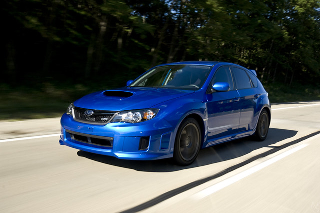

Drive down the highway. Have you friend go 70mph. Have the driver of your car slowly pass him on the right side to be able to ge every angle. Shoot at 1/60th or 1/80th with the aperture to compensate for the exposure.
f/9 1/80th ISO 100 24mm.

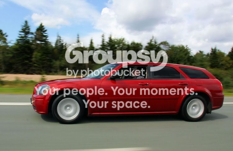

Not sure if this is what you're looking for, 1/50 sec @f/16. My son the photographer took this of me in my Magnum a few years ago:
Those shots are pretty much what I'm looking for, just with a lot more aggression.
More aggression means getting a rig so you can get the camera lower to the ground.
