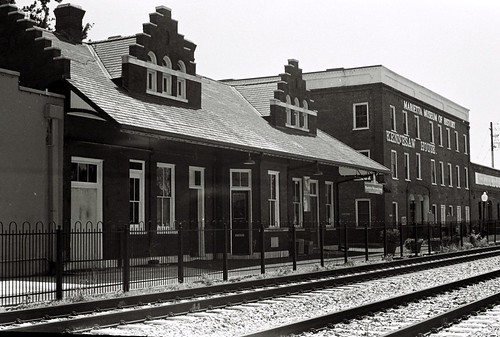

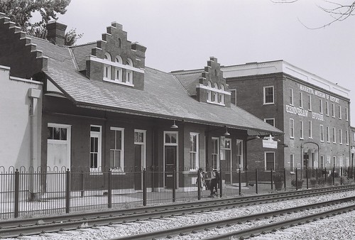

Same scene, same day, two different films... Minimal PP on the TMAX, no PP on the Ilford. Both taken with OM2N / Zuiko 50MM
TMY 400
TMAX Devloper 1:4 7 min @ 68f
Kennesaw House II by Nokinrocks, on Flickr
Ilford 125 FP Plus
TMAX Devloper 1:4 8 min @ 68f
R2-E065 by Nokinrocks, on Flickr
Hmm, the FP4 looks flat.
I don't use TMax developer (Ilfosol S or Rodinal), so I am not sure if that is causing this.
The shadows are different ... looks like different lighting conditions.
These were shot at different times during the day, though, no? At least several hours apart, I would guess.
Yeah, took one mid day (tmy) other a few hours later.
What are you hoping to see in this comparison?
The scanner settings will have a big effect on how the two pictures look - apart from the obvious difference in lighting direction the scanner settings alone could account for much of the difference in appearance. To do a proper comparison you would really have to begin by developing to the same contrast.
Helen - Really only showing results of both shots... Didn't intend to do a comparison that day, just ran out of tmy and loaded the ilford and took another shot . Thanks for the reply...
