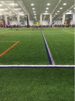

field.webp Hi all,
New to this forum. I hope to learn a lot from here and help where I can.
I'm looking for some suggestions on what settings I should/could shoot for this type of area. It is indoor soccer with pretty much no outside light. The pre set settings don't do much so I want to go full manual. I took this photo with an iPhone. I am using a Canon T3 wit a 75-300 lense. Maybe when I have $$ I can get faster glass but this is what I have to work with for now. Any suggestions would be appreciated.
Thanks!
I would shoot a venue like this in nothing BUT full manual. Once I peg the white balance, and choose a suitable ISO/apterture/shutter speed that works with the lens I would be using, then there would be no need to do any post-processing, especially in terms of white balance. I can't suggest any ISO/apterture/shutter speed combination as that all depends on how bright the lighting is, and that's not something any of us here can tell you.
This is basically a set, predictable lighting set-up. Once I have everything set, I can concentrate on shooting.

Looking at your picture the lighting is very even except right in front of the iphone was somewhat darker but may be 1 stop. Shouldn't be any problem to pick the right setting. You should do that before hand.
