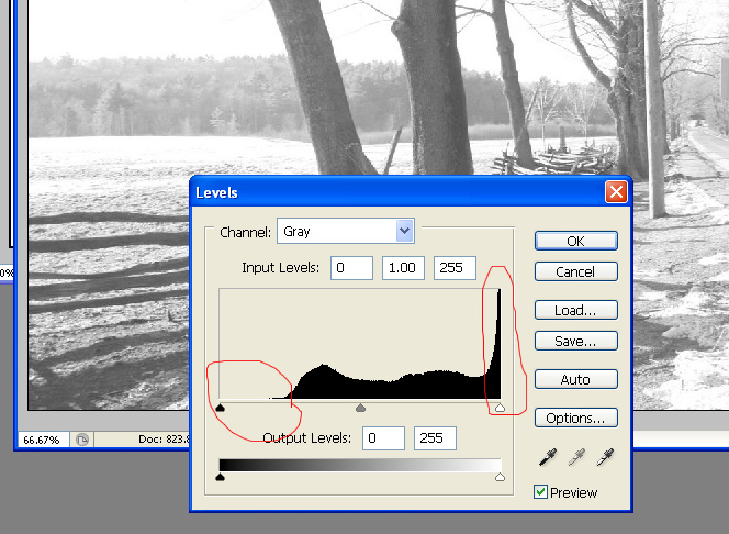

I'll use the second image as an example. It's been overexposed. Here's where a histogram comes in handy (check your manual on how to see one in-camera!) This one comes up when adjusting levels in PS.
See the red circle on the right? That ramp up shows that there is a whole lot of white in the image. For a well exposed image, it should taper down, like on the left, but stop right at the edge.
On the left, there is no black. It has the taper, but the taper should go to the edge.

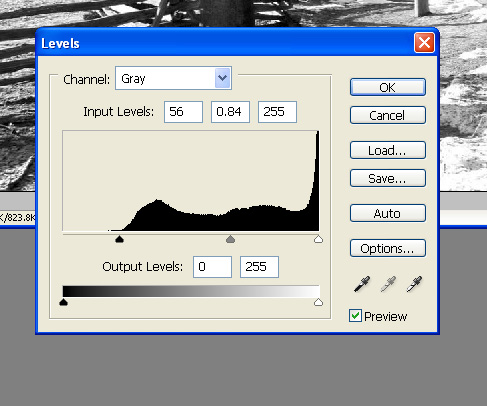

There's no way to fix the overexposure. All that white will stay one color, no matter what. But you can bring black back into it. Using levels, shift the triangle below to where the ramp starts. You can hold down alt while you do this to see what pixels are being affected. The screen will be all white, and then when you start seeing black dots just start to appear, stop. You can move the middle triangle to adjust the midtones.
You end up with this (I resized it, too):
You now have black, white, and everything in between. When you shoot, check your histograms. If you see a ranmp up at one side or another, shift the exposure. If it ramps up on both sides, the exposure difference in the scene is too great for your camera to capture. That's when you have to make a creative choice as to what you like better.
