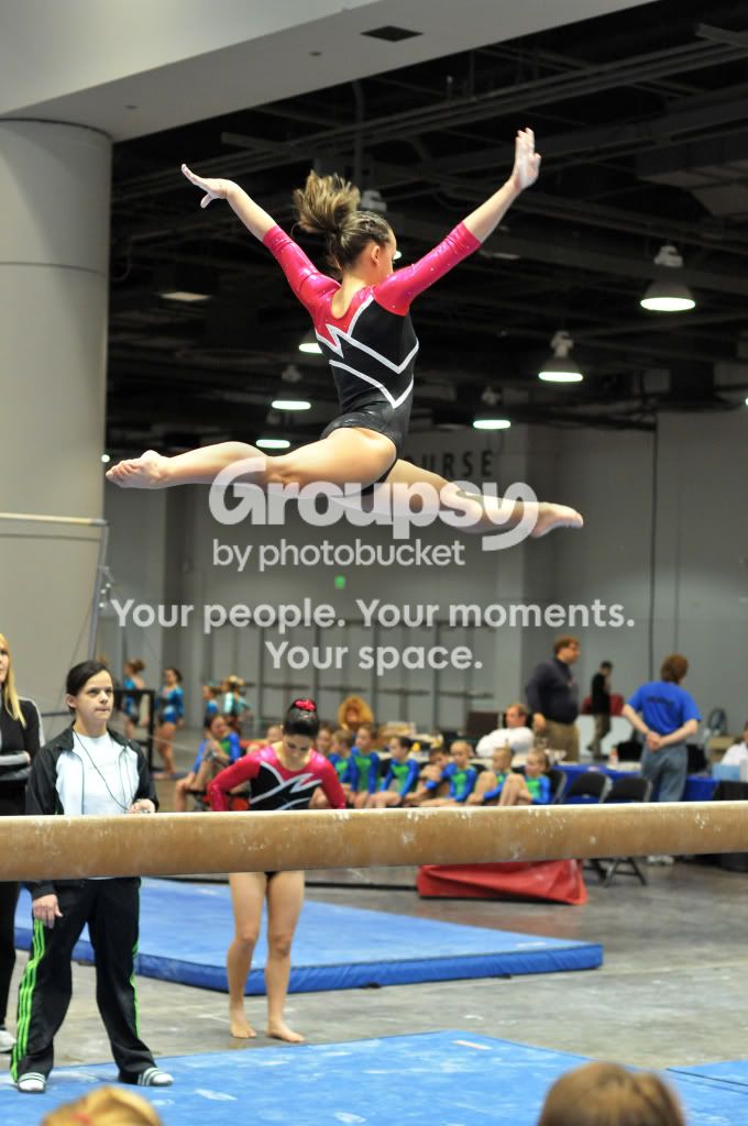

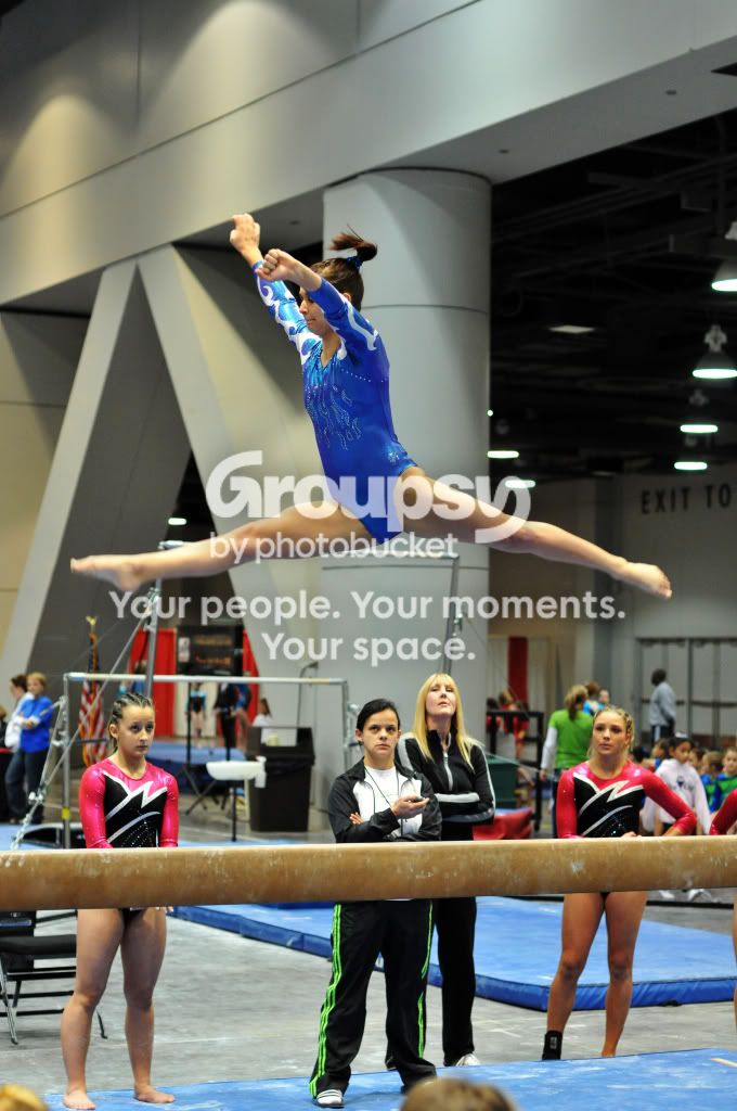

For gymnastics I don't use a monopod, or tripod because they are moving too fast. Here are a few shots from the last event:
Thanks for posting them!
