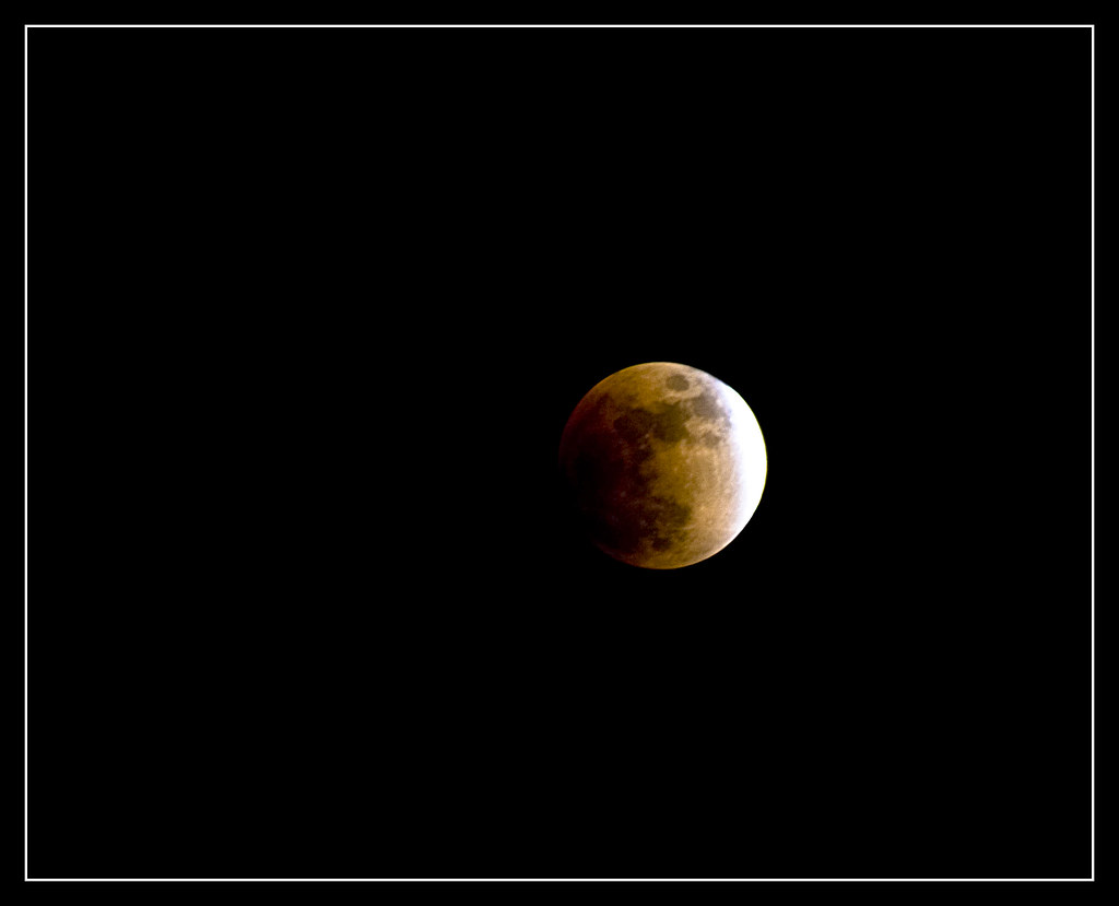

I did get some shots of the eclipse last night
here is one of the better ones.....But it is a little blurry due to the 2 second shutter speed that was used \.
