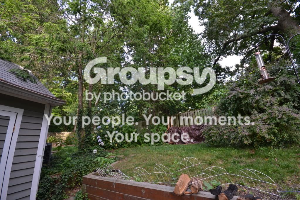

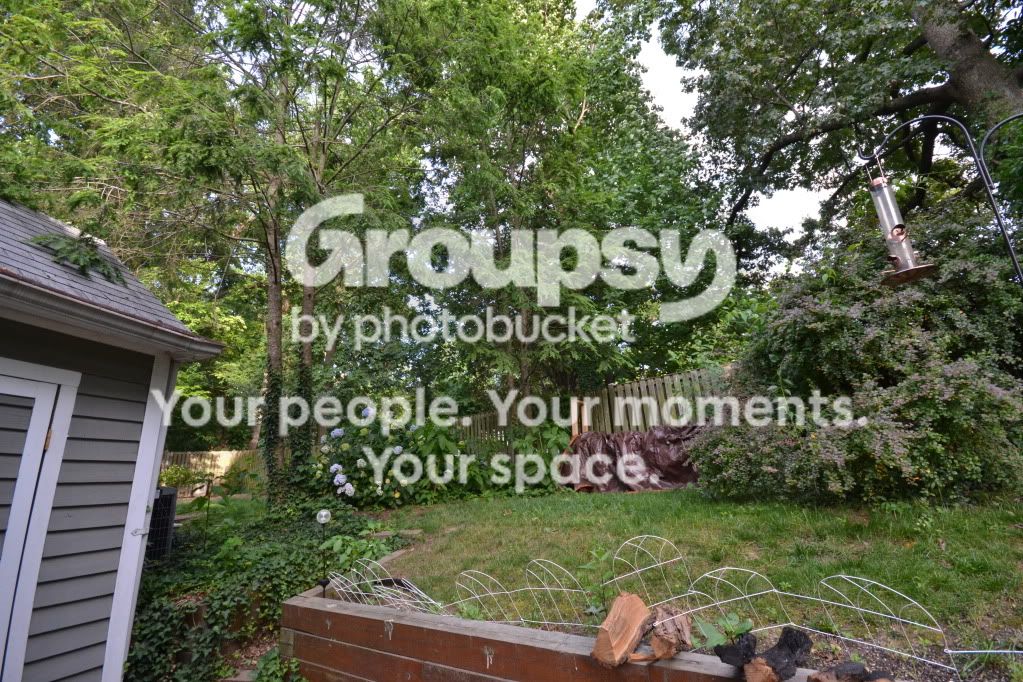

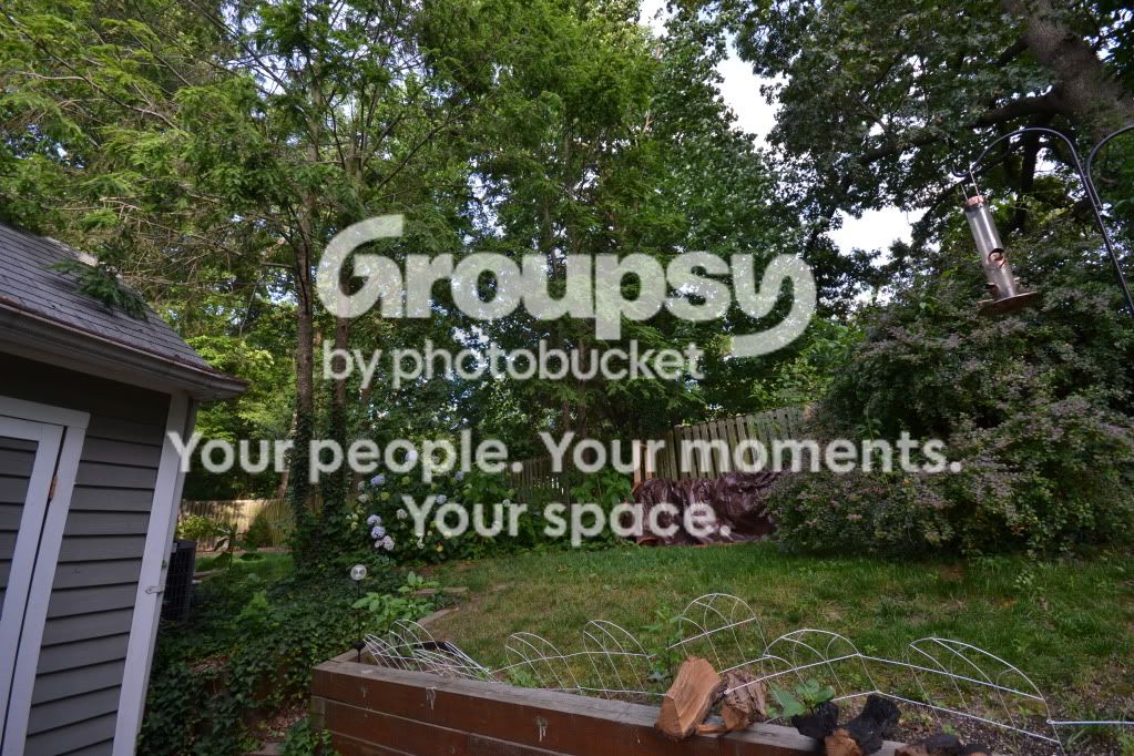

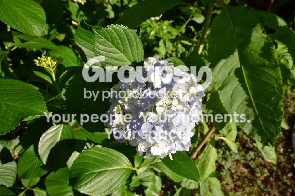

Howdy. I just purchased the Sigma 10mm lens for some real estate photog and took a few test shots. I've read that many people have gotten bad copies of this lens that aren't sharp but have returned it for a new copy that was sharp. I problem is, I'm not sure if my copy is as sharp as other "sharp" copies. I took many test shots through all the apertures at different speeds and wanted to get some other opinions on the performance. Below are what I think are the sharpest of my test shots. Please let me know what you think.
1 1/50 F8 ISO 200 10mm
2 1/100 F8 ISO 800 10mm
3 1/50 F9 ISO 400 10mm
4 1/100 F8 ISO 100 16mm
Its hard to tell how sharp they are on here and compression can effect the sharpness, though I think the parts of you examples that are in focus are pretty sharp. I have had the 10-20mm 4-5.6 for several years, use it all the time and am very satisfied with it. Even though I am currently on a Canon L buying kick, I have no real desire to replace my 10-20mm 4-5.6.
You should post 100% crop examples. It's hard to tell the sharpness of these photos when they're low-res
Would it help to include the direct link to photobucket? Id like to see if they're sharp across the entire image.
Is the edge sharpness as terrible as it's said to be with this lens...
Well, there's a lot of perspective distortion around the edges at 10mm, as there are with all super wides, which a lot of people confuse with being 'soft'. A lot of it comes from people comparing this lens at 10mm to another lens at 14mm. At 20mm this lens is as sharp around the edges as any wide angle zoom I've found. At 10mm, there are really only a couple of lenses that even go to 10mm, and I don't find any of them to be appreciably softer around the edges or have more perspective distortion than this one does.
People just aren't used to shooting with 10mm lenses most of the time when they get this lens, and they don't understand how to use/minimize perspective distortion.
That isn't to say a few aren't legitimately soft around the edges, but I've used 2 of them now, mine and a friends, and both were as sharp as any wide angle zoom I've ever used around the edges.
