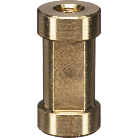

What is a standard light stand mount? Is it the same 1/4" or 3/8" screw as a tripod?
I'm looking at buying a portable softbox / L-bracket setup like this one. Would I able to mount that on a tripod?
I would call a 5/8" spigot a 'standard light stand' mount of that approximate size (The next size up is 1-1/8"). The light stand has a spigot, the light has a socket. You can get 5/8 spigots with 1/4 or 3/8 female thread at one end.
Best,
Helen
Here is a link to a photo of what you would want to buy, in order to mount that onto a tripod's threads: a 5/8 inch spigot, female threaded at both ends. One end is 1/4x20 National Coarse, and will fit your USA-market tripod screw, the other end is a 3/8 thread, which is handy if you wish to remove the tripod head, and mount directly to the 3/8 inch thread that is underneath, and used to hold the head onto the leg set.
http://www.adorama.com/images/large/BG3108.JPG
