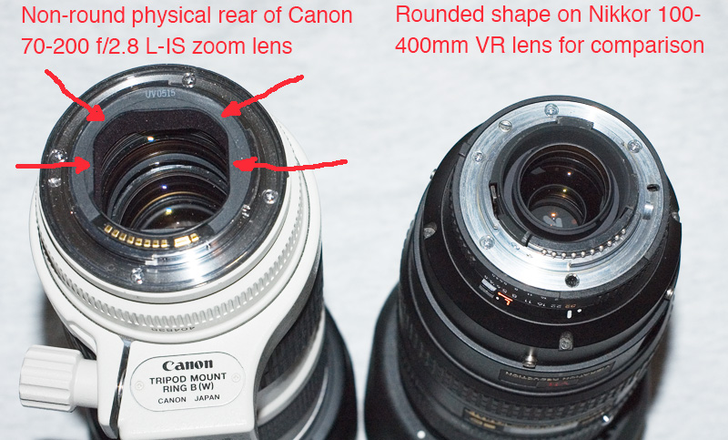

Bokeh "balls" are NOT always perfectly rounded!!!! In fact, they may be elllipsoidal or otherwise weirdly out of round. In some situations, some of the light rays are being "clipped" by mechanical vignetting, either at the rear of the lens, or in the mirror box of the camera. I have a couple images on my pBase upload space, but cannot find them in the 7,000 images on-line there, showing the effects of mechanical vignetting from my Canon 70-200 f/2.8 L IS USM zoom and Canon 5D Classic camera; it cannot render truly ROUND bokeh balls on point light sources, but instead produces what are often called "cat's eye" bokeh, or "footballs".

Well, so much for the theory of the square mount aperture! These are from the
28-300
And, the 70-200 f/4
Both also have the pointy football shaped balls, but they have round mount apertures. It definitely looks like a Canon thing, but it isn't the rectangular aperture.

As you can see from the baffled rear and deeply recessed rear element on the 70-200 2.8 L- IS USM, that lens on the 5D produces elliptical bokeh balls wide-open ALL OVER THE ENTIRE frame, not just at the edges. The Canon is suffering from ellipsoidal or "Cat's eye" shaped highlights to a VERY serious degree...not one or two bokeh balls, but every one of them is elliptical...

I see that. I also see that the three shots I posted, with three different lenses, first with the 70-200 2.8 L IS USM, then with a 28-300 L, then with a 70-200 f/4 L, all shot with a 5D Mk III, look pretty much the same. If it had anything to do with the baffled rear and deeply recessed rear element, the other two photos should look different since the other two lenses don't have that rear element arrangement. I'm wondering if it has to do with the microlens on the sensor, since the Mk I and Mk III apparently get different bokeh from the same model of lens. As time permits I will try out different bodies and lenses to see if differences become apparent.
