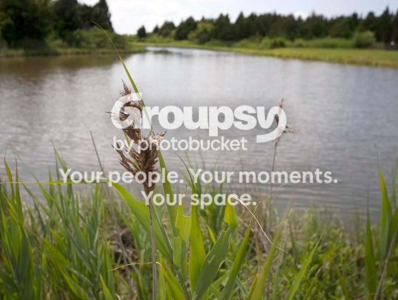

If I understand what you're asking (and I'm not sure that I am), wouldn't you have better luck with a wider lens and get right up on top of that flower?
Compression from telephoto:
Ultrawide angle close to main subject:
I looked at your photos and the one with the yellow and blue flowers with the mountains in the bkgd is what I was talking about. Although the flowers in the fgrnd were a little oof (on my laptop screen), that is what I'm going for. What lens did you use? Nice shot. Thanks, TB
Yeah, that was actually the image I was looking for when I posted these. That was with a Sigma 10-20mm at 10mm on my Canon 30D.
