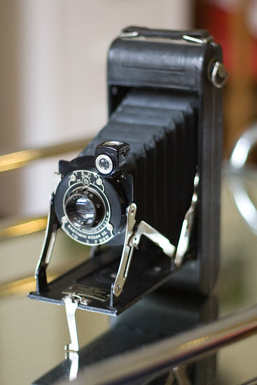

Here's a photo of my latest toy, an Eastman Kodak No 1a Pocket Camera. I have hacked it to use it with 120 roll film.

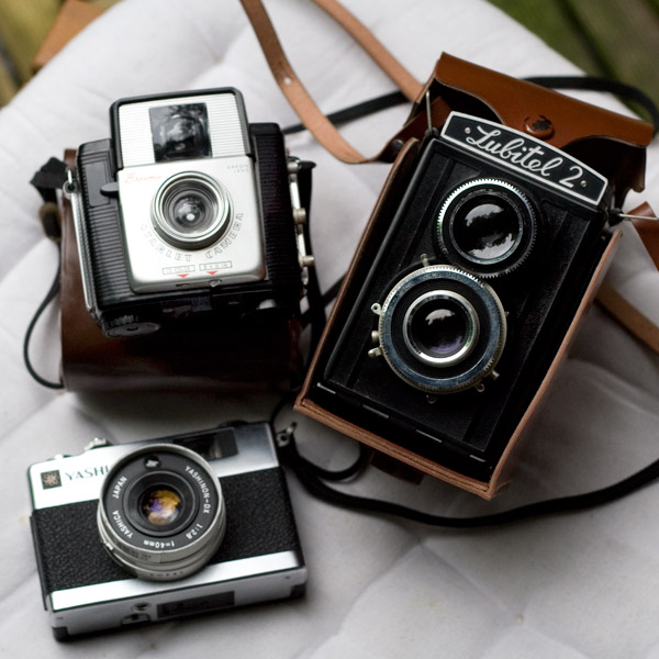

When have you started to collect old cameras, Jeroen? Have I missed the point when you began?

I started collecting about half a year ago when I had started shooting with my old Pentax SLR 35mm camera again and ran into a nice Minolta Autocord two-eye mid format camera a week later. Then I bought a couple on some flea markets for almost nothing and then I was hooked :lol:
That's a beautiful camera. I guess they had different size pockets back then.
I imagine that folded back, that one's as small as one of the second-generation mobile phones? Maybe?
Yes, folded back it is about 20cm x 9cm x 3cm so it does fit into the pocket of a jacket. You do need to bring a handheld lightmeter though :-)
Shutterspeed is a choice between T, B, 1/25 and 1/50. It runs from f7,9 all the way to f45. Negatives are 11cm x 6,5cm.
There's a slide at the back where you can make notes on the film with the a little iron pen that came with the camera. You need the original film for that though, wich had carbon paper attached to it. That film is not available anymore.

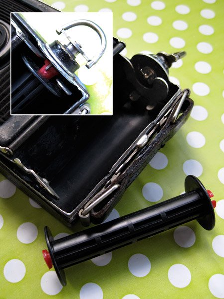

The original film spool is bigger then 120 roll film so I made some adjustments. Basically jaming a couple of cut up wall plugs into a 120 spool. Worked perfectly.

That's a wide format! (The more I say the more you will notice how little I know about film cameras beyond the usual 35mm). Very interesting. What do "T" and "B" stand for? F45! Wow. Was it used in any of your example pics? And did you test out how it performs wide open?
Well, B is "bulb" just like on your DSLR. Shutter is opened when you press it and closed again when you let it go.
T opens the shutter when you press the shutter release and closes it when you press it again. So you can press it, run through the image and press it again :D
I shot all of these on 1/50 with f32, like my handheld meter told me to. The photo's are not really that great. I want to go back when the sunny weather is gone and take a tripod so I can take shots that are not so hard in light (and levelled LOL).
