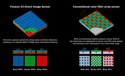

No no, resolution will be way higher.
Every pixel in a standard sensor is extrapolated over 3-4 actual pixels (which are each only one color). Other pixels also share this information for their own extrapolation. Here, though, they won't share. They will actually collect all their own information. That leads to much higher actual resolution.
The reason you are confused is because current megapixels numbers are very misleading. An 18 megapixel Bayer sensor has the resolution ability of what is actually more like a 6 megapixel foveon sensor. Yes, it ends up with 25 million pixels, but they are all redundantly sharing information with one another and thus cannot actually resolve lines with as few pixels as you would expect.
This new sensor would actually be a 25 megapixel sensor, but a REAL 25 megapixel sensor, not the misleading "25 supposedly but actually acts like 8.3" that you currently get when you buy a "24 megapixel" sensor.
Long story short: Don't worry about the number confusingness. Resolution will indeed be that of an effectively 3-4x higher megapixel count. Or a linear resolution improvement (like lines per mm in a single direction) of 2x
The 75 number is just what it would be if you perpetuated the dishonest / lying sort of marketing terminology that the companies all currently use.
http://www.ephotozine.com/articles/...w-20388/images/sigma-foveon-sensor-larger.jpg
Edit: it might be possible to get the same resolution in monochrome with current sensors, with fancy software, since in Black and White, you essentially have a useful data site at every position (I'm talking about shooting in color than converting to B&W with advanced custom software). But nothing like this happens normally or by default with mdoern cameras.
The number I've seen thrown around for a Bayer sensor is 2:1. So, an 18 megapixel Bayer array "usually" produces an effective resolution of 9 megapixels of RGB image. It depends on the image. The 75 megapixel Foveon will always, always, every single time, produce a 25 megapixel RGB image.
