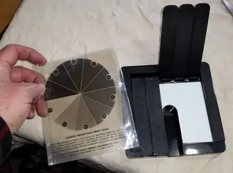

There are devices you can use to make various 'test strips'. One uses plastic 'fingers' you can drop down during a long exposure. I use a Patterson one. Kodak made a 4x5 'projection print scale' that had pie-shaped gray wedges. You'd place the paper under it, expose the image for 60 seconds, and you'd have 2, 3, 4, 6, 8, 12, 16, 24, 32 and 48-second test images.
The test strip with a white cover sheet and 5 second exposure with the negative in place. That's the old way
