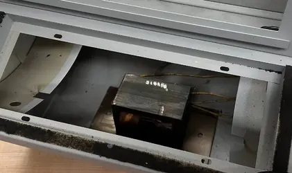

Hi. I am trying to fix an old Thomas Duplex safelight, and can't find the necessary parts. I've already bought a new SOX 35w bulb which didn't solve the issue, so I suspect that the magnetic ballast is at fault. There doesn't seem to be a lot of information on where to get replacements, and most ballasts have a separate capacitor, which mine does not. Any advice? IMG_0602.webpIMG_0603.webp

The ballast is for a fluorescent lamp, so it won't work for a LPS lamp. Your images only show the ballast. Is there not a start capacitor?

I don't see a separate start capacitor, and the only components in the fixture are the ballast shown in the images and the bulb socket. I've used an identical safelight before and the heat has never been an issue, even after running for many hours. I'm not looking to buy another one since I have other safelights and just want to learn more about this one, but I appreciate the offer.
The missing capacitor may be the issue.
